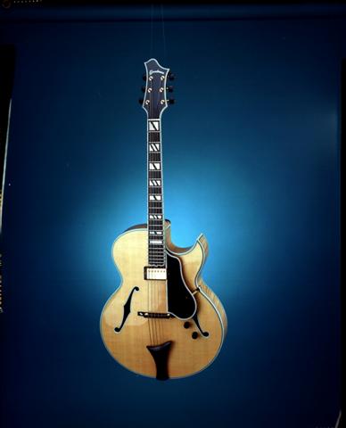

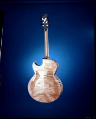

I got commisioned to make a few cut-in pick up guitars and I built one on spec.
Since I only make solid wood guitars that is the only way I could do that.
I suppose I could have bought some plywood plates,but that would ceartainly limit the figure of the wood I could have used and I really had no interest in making a laminated guitar.
Here's a picture of my L-5XE model (x-braced):
PostPosted: Thu Mar 02, 2006 12:01 pm
Beautiful Brad!!   I get your point -- it's cosmetic.
